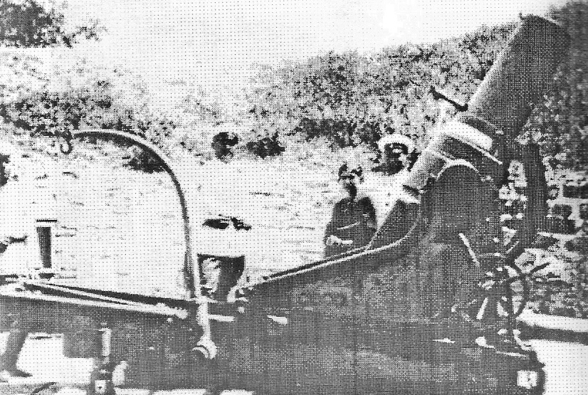

      :sm100: I understand that these guns were in fact Krupp 10cm Kanone 14 (actual cal. of 105mm of course, with a barrel length of L/35) which according to the author Franz Kosar were provided to the Bulgarians by the Germans shortly after the war began. There was in fact the earlier German 10cm Kanone 04, which he does not seem to indicate any exports for. The Turkish 10.5cm L/30 listed above was largely modeled on this earlier German gun. As for the Krupp 15cm M-1913 howitzer, this was not at all the same weapon as the German service 15cm sFH-13 (this weapon was, however, used by the Ottoman Turks during the war, and by the Swiss, who called it the sFH M-17) shown in the one of the photos above, but rather the commercial update of the earlier 15cm Krupp M-1906 field howitzer, better optimised for motor towing. The M-1906 was exported to Sweden (these had no shields) and Bulgaria (with shields). The above referenced Turkish 15cm L/14 field howitzer was largely identical to the M-1906, even though it appeared slightly earlier. Argentina also used a Krupp 150mm M-1904 field howitzer (actual cal. 149.1mm?), and seems to have been the first export customer for this type of weapon. The commercial Krupp M-1913 was built under license in Italy by Ansaldo and Vickers-Terni, hence the Italian origin of these weapons in Bulgarian service (I wonder if however Bulgaria might not have gotten some during the war directly from Krupp to supplement the earlier M-1906?) In Italy this howitzer was designated "Obice da 149/12 modello 1914A" and there were also modello 1916 and 1918 variants, with the mod. 1914 and 1918s produced in the most quantities. I suppose that it is perfectly possible that the Bulgarians received some small quantity of ex-German Army 15cm sFH-13s during the war, but it has to be remembered that its ammunition was not compatible at all with the stocks used with the then Bulgarian service 15cm field howitzers (Krupp M-1906, Schneider M-1897, Schneider M-1912). All the German service field howitzers used a 149.7mm shell, whereas the commercial Krupp export products fired a 149.1mm projectile. Please see my new article on these weapons to be posted shortly on "Landships" and Dominique LeMaire's "The Guns Of the Second World War" (lemairesoft.be). In it is a post war photo of what I believe are Bulgarian Army Pavesi P-4-100 artillery tractors towing Krupp 15cm M-1906 field howitzers. One other note: Russia did not use 150mm caliber weapons; theirs were chambered for 152mm. See the list above covering ammunition deliveries.

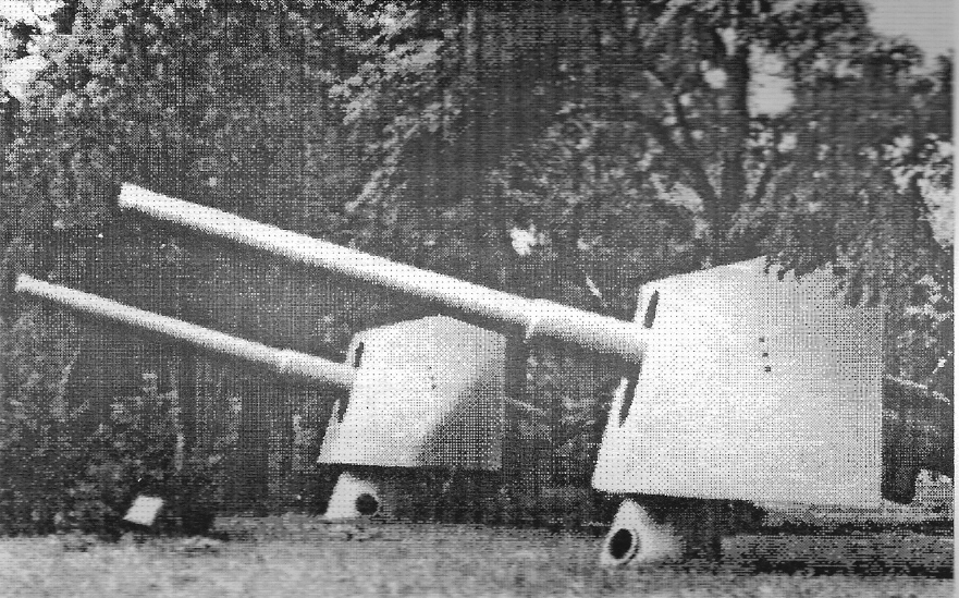

        :not: I think you had better take a real close look at the color (autochrome?) photo of what is purported to be the Skoda 15cm M.14 or M.14/16 field howitzer. It is in fact of a Russian Putilov 152mm M-1909 g. field howitzer. Look particularly at the cradle details and the shield, and compare with the other photos that were posted in the same thread. I was not aware that Bulgaria received any of these howitzers, if so when and app. how many did she get? I just recently discovered that Turkey had some when I was working on my article on this very weapon. See my upcoming article on these howitzers on "Landships" or lemairesoft.be.
