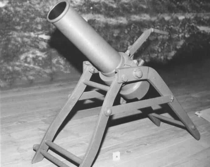

    9cm light Minenwerfer Lanz
    Gun model : 9 cm Minenwerfer Lanz
    German designation : 9 cm Minenwerfer Lanz
    Calibre : 91.3mm L/6.5
    Weight in action : 114 kg
    Barrel lenght : 0.60 m
    Shell weight : glatte leiche Wurfmine : 3.8 kg (360 gr of explosive)
    Granatmine : 3.5 kg (375 gr of explosive)
    Max. range : 75/450 m (Wurfmine : 320 m)
    Elevation : up to 75°
    Remarks : Stop-gap trench mortar introduced 1915. It was manufactured in Mannheim by Heinrich Lanz. The barrel was made of sheet steel for the 91.3 mm caliber and was mounted of a folding sled, fixed onto a wooden plate with iron reinforcements. According with NEDEFF, Les opérations en Macédonie. L'épopée de Doïran, page 104 (I use the French translation), 9th Plevenska Infantry Division had 10 MW Lanz in 1917 at Doiran.
    For other information and images of this mortar see :
