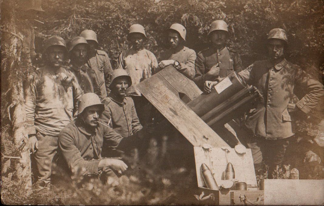

    German Minenwerfer (Mine launchers)
    The siege of Port Arthur in Russian-Japanese War (1904-05) showed that the fire of heavy guns alone was not sufficient to take a modern fortification, since not all obstacle could be cleared by them. It also took close-quarter weapons capable of dropping a heavy explosive charge exactly onto a target a few hundred metres away. This was true expecially for barbed wire obstacles, which the artillery found troublesome to clear. On that basis the Engineer Committe of German Army in 1907-12 planned and built three kind of mine launchers: heavy, middle and light.
    The main features of these weapons were:
    - lower muzzle velocity compared to field or heavy artillery;
    - scarce range of fire;
    - not high weight ;
    - shell with powerfull explosive charge.
    Indeed the effect of the shell of a 25cm Minenwerfer was equal to that of a mortar of 28cm or 30cm, which weighed more than ten times.
    At the beginnig of the war German Army had 44 25cm and 116 17cm Minenwerfer. The 7.7cm Minenwerfer was tested before the war started, but was assigned to the units only at the end of the year. Like the 42cm heavy mortars, they were kept in secret. They showed their potentiality during the siege of Liege, Namur and Maubeuge and proved to be very useful also in trench warfare. Other Army had no mine launcers in 1914 and France had to press into service a range of ancient mortars dating to the beginning of 19th century, until more modern weapons were built.
    Germany gave to Bulgarian Army only a little number of heavy and medium Minenwerfer and ASIK no 38cm ssMW (sehr schwere = very heavy) and no 24cm Fluegel Minenwerfer were sent to Bulgarian Army.

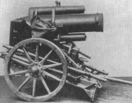

      #32

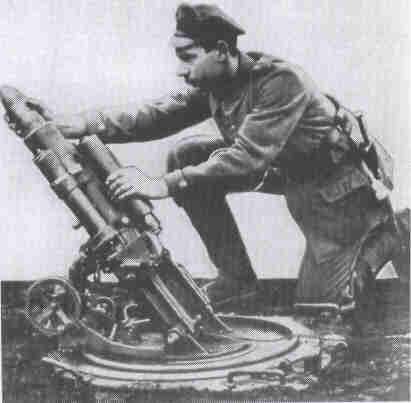

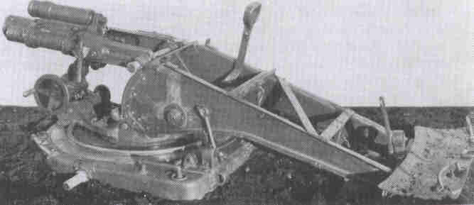

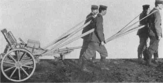

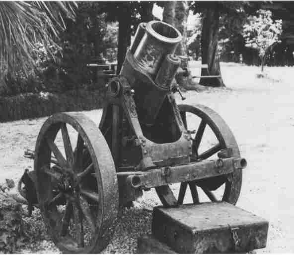

      Light Minenwerfer
      Gun model : Rheinmetall light Minenwerfer Old pattern
      German designation : 7.7cm lMW a/A
      Calibre : 75.8mm L/5.2
      Weight in action : 102 kg
      Tube Lenght : 0.41 m
      Shell Weight : 4.6 kg (0.56 kg of explosive)
      Muzzle Velocity : 70 m/s
      Max. Range : 160/1050 m
      Elevation :
      Rate of fire: up to 20 rounds a minute for short periods
      Personnel required to carry the MW into action : 6 men
      Remarks : Introduced in late 1914.

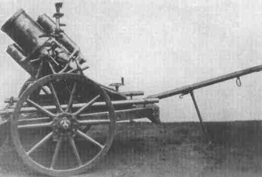

      Gun model : Rheinmetall light Minenwerfer New pattern
      German designation : 7.7cm lMW n/A
      Weight in action : 140 kg
      Weight on march : 215 kg
      Muzzle Velocity : 77 m/s (with the lowest charge)
      121m/s (with the highest charge)
      Max. Range : 160/1300 m
      Elevation : + 27° / 0 (in the low-angle mode)
      + 75° / + 45° (in the high-angle mode)
      Remarks :
      Introduced in 1916. Since the front of the bedding was shaped like a semicircle, it was able to traverse 360°. It could fire light gas shield too. It could be carried either by two men with the help of poles, or, after two wheels of 75cm diameter had been stuck onto the axles of its bedding, drawn by hand (see the picture).

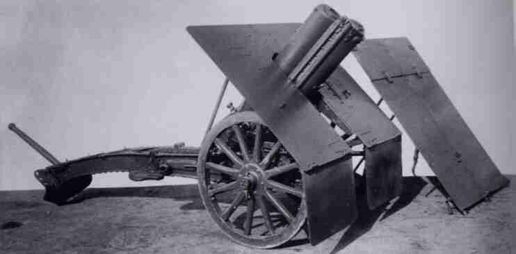

      9cm light Minenwerfer Lanz

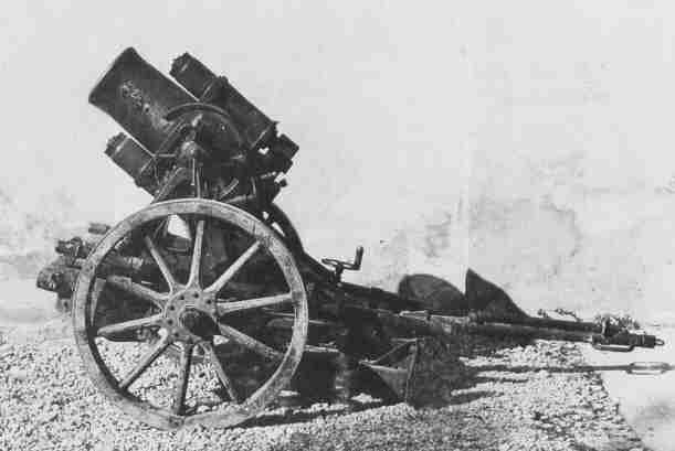

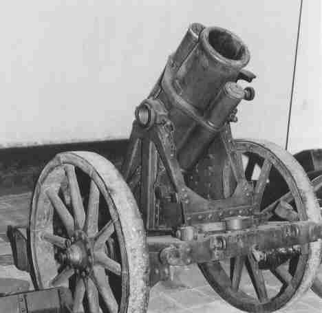

        Medium Minenwerfer

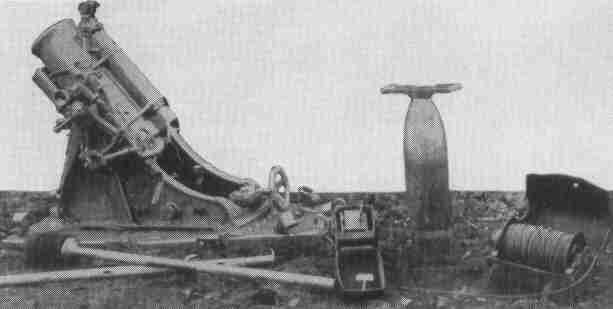

        Gun model : Rheinmetall medium Minenwerfer Old pattern
        German designation : 17cm mMW a/A
        Calibre : 170mm L/3.8
        Weight in action : 482 kg
        Tube Lenght : 0.646 m
        Shell Weight : 49.5 kg (12 kg of explosive) - 42 kg (gas shell) - 37.4 kg (incendiary shell)
        Muzzle Velocity : 58 m/s (with the lowest charge)
        Max. Range : 150/900 m (300/1300 m with gas shell)
        Elevation :
        Rate of fire: 30/35 rounds per hour (40/45 with gas shell)
        Personnel required to carry the MW into action : 17 men
        Remarks : Introduced in 1913.

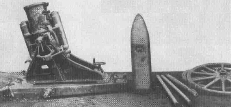

          Heavy Minenwerfer
          Gun model : Rheinmetall heavy Minenwerfer Old pattern
          German designation : 25cm sMW a/A
          Calibre : 245mm L/3
          Weight in action : 660 kg
          Weight on march : 955 kg
          Tube Lenght : 0.750 m
          Shell Weight : 97 kg (50 kg of explosive)
          Muzzle Velocity :
          Max. Range : 150/550 m
          Elevation : + 75° / 20
          Rate of fire: 20 rounds per hour
          Personnel required to carry the MW into action : 21 men
          Remarks : Introduced in 1910.

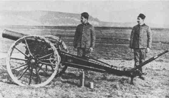

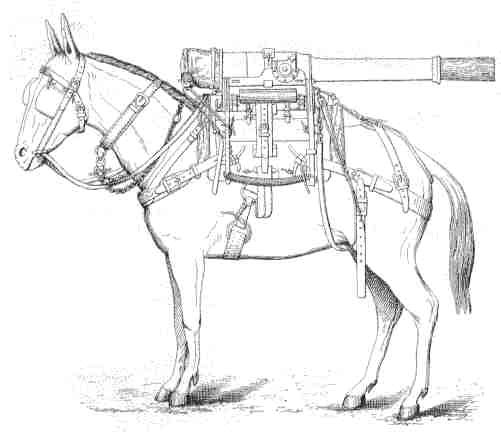

              Gun model : Skoda 75mm QF M. 1915
              Austrian designation : 7.5cm Gebirgskanone M 15
              Calibre : 75mm L/13
              Weight in action : 613 kg
              Tube Lenght : 0.975 m
              Shield thickness: 5 mm
              Shell Weight : 6.3 kg
              Shrapnel Weight : 6.55 kg (280 lead bullets or 160 steel and 10 lead-antimony bullets)
              Muzzle Velocity : 365 m/s
              Max. Range : 6800 m
              Elevation : + 56° / - 9’
              Remarks :
              Quick firing mountain light howitzer. It could be dismantled into six parts (gun = 106 kg; shield and fittings = 86 kg; cradle 98 kg; wheels = 95 kg; carriage - front = 110 kg; carriage - back = 51 kg), generally carried in four loads.

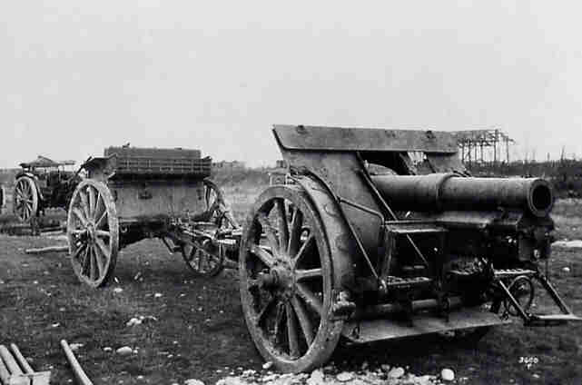

                #37

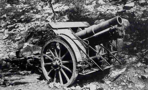

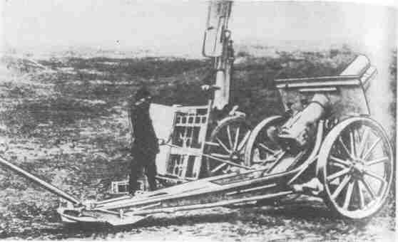

                Gun model : Skoda 150mm QF M. 1914/1916
                Austrian designation : 15cm Hubitz M 14/16
                Calibre : 150mm L/14
                Weight in action : 2765 kg
                Tube Lenght : 2.100 m
                Shell Weight : 42 kg
                Muzzle Velocity : 340 m/s
                Max. Range : 7900 m
                Elevation : + 70° / - 5’
                Remarks :
                Quick firing heavy field howitzer. It was also converted for mountain transport, divided in four loads. Following Austro-hungarian exemple, German Army converted 7.7cm FK 96 n/A, 10.5cm lFH 98/09, 15cm sFH 02, sFH 13, 10cm K 04 and 10cm K 14. They were all transported in two loads: tube and carriage (later three loads). In the picture are shown the solution adopted for 15cm sFH 02.

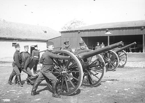

                      ex Serbian Field Guns
                      General remark:
                      The guns and howitzers used by Serbian Army during World War I were generally very similar to those adopted by Bulgarian Army. Obviously the artillery of a more recent pattern have some little improvements, but no really significant alteration was introduced between 1907 and 1912.
                      Gun model : Schneider-Creusot 75mm QF M. 1907
                      Calibre : 75mm L/31
                      Weight : 340 kg
                      Weight in action : 1040 kg
                      Tube Lenght : 2.325 m
                      Shell Weight : 6.4 kg
                      Shrapnel Weight : 6.1 kg (320 balls)
                      Muzzle Velocity : 550 m/s
                      Max. Range : 7300 m
                      Elevation : + 16° / - 5°
                      Remarks : Quick firing field gun.
                      Gun model : Schneider-Creusot 75mm QF M. 1912
                      It was the same gun which French Army had adopted as its artillery gun. Since its features are inferior to the standard 75mm Mle 1897, French Army ordered only a little number of this gun. It fired the same ammunition as M. 1907, but was lighter than it (weight in action was only 965 kg). See also Post 109.
                      Gun model : Krupp 75mm QF M. 1904
                      It was the same gun captured from the Turks by Bulgarian Army.
                      Thanks to The Edge for the corrections and the additions.

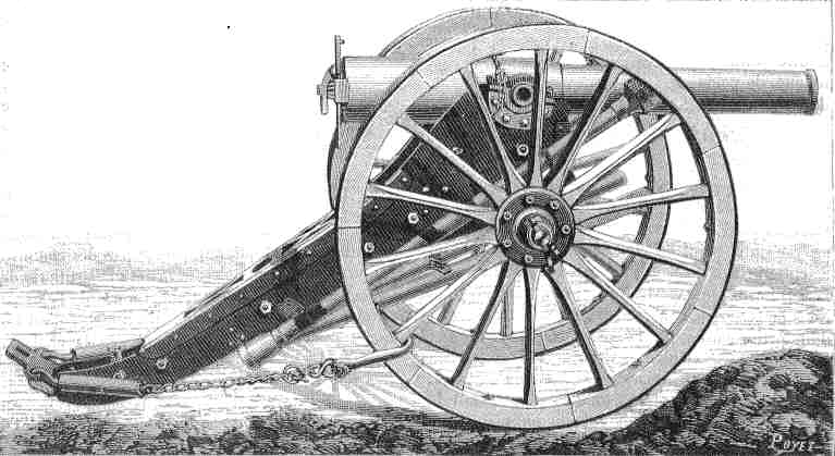

                        #41

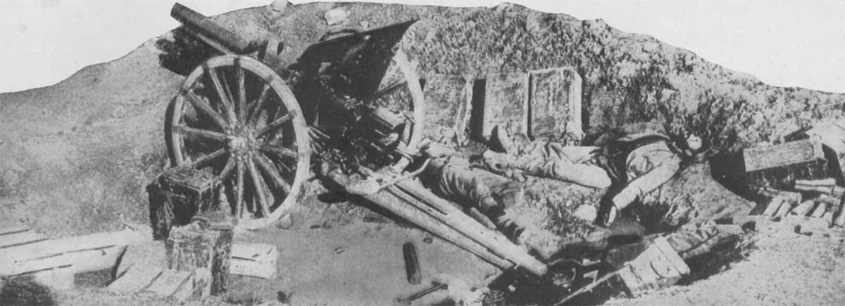

                        Gun model : 80mm De Bange M. 1885
                        Calibre : 80mm L/28.8
                        Weight : 424.5 kg
                        Weight in action : 925 kg
                        Weight with limber : 1595 kg
                        Tube Lenght : 2.304 m
                        Weight of Cartridge : 1,5 kg
                        Weight of Shell : 5.8 kg
                        Weight of Shrapnel : 6.1 kg
                        Weight of Case Shot : 5.55 kg
                        Muzzle Velocity : 472 m/s
                        Max. Range : 6000 m (shrapnel), 7000 m (HE shell)
                        Elevation : -8°30’ + 22°30’
                        Remarks : Slow firing field gun.
                        Thanks to The Edge for the corrections.

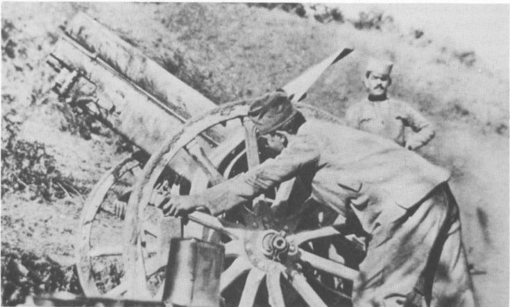

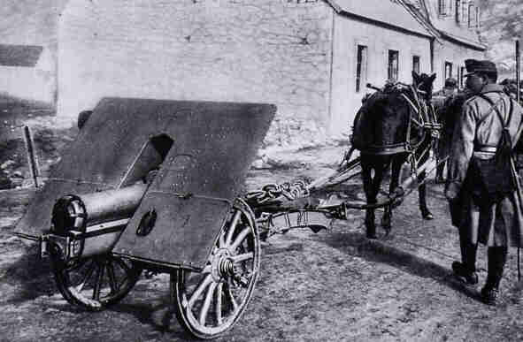

                          Gun model : Schneider-Creusot 70mm QF M. 1907
                          Calibre : 70mm L/17
                          Weight : 98 kg
                          Weight in action : 508 kg
                          Tube Lenght : 1197 m
                          Shell Weight : 5.3 kg
                          Shrapnel Weight : 5.3 kg
                          Muzzle Velocity : 300 m/sec
                          Max. Range : 5000 m
                          Elevation : + 20° / - 12°
                          Remarks :
                          Quick firing mountain gun.
                          5 load: 1 - gun; 1 - axle; 1 - shield and fittings; 1 - cradle, 1 - trail and wheels
                          It was the standard Schneider export mountain gun. It was supplied also to Italy ans Spain as their M 1908. The Schneider mountain guns adopted by Bulgarian army was the same weapon, but adopted a 75mm cailbre gun in order to standardize the artillery.
                          Calibre : 80mm
                          Weight : 105 kg
                          Weight of Cartridge : 0.4 kg
                          Weight of Shell : 5.6 kg
                          Max. Range : 5000 m
                          Remarks : This mountain gun was developed from 90mm De Bange field gun. It was adopted by French Army on 25 July 1878.
                          3 load: 1 - gun; 1 - carriage; 1 - trail and wheels

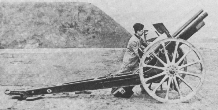

                            #43
                            Gun model : Schneider-Canet 150mm QF M. 1911
                            Calibre : 150mm L/12
                            Weight in action : 2285 kg
                            Tube Lenght: 1.800 m
                            Muzzle Velocità : 300 m/s
                            Max. Range : 7800 m
                            Elevation : + 43° / - 3°
                            Traversing angle : 5°
                            Quick firing heavy howitzer. It was derived from the 152.4mm M1910 howitzer built by Schneider for Russian Army.

                                #45
                                Gun model : Schneider-Canet 120mm mod. 1897
                                Calibre: 120mm L/12
                                Weight : 497 kg
                                Weight of carriage : 872 kg
                                Weight in action : 1368 kg
                                Weight of gun train : 2230 kg
                                Tube Lenght : 1.440 m
                                Shell Weight : 16.4 kg.
                                Shrapnel Weight : 16.4 kg. (276 balls x 13.83 gr)
                                Muzzle Velocity : 315 m/s
                                Max. Range : 6000m /4500m
                                Elevation : + 45° / - 5°
                                Traversing angle : 4°
                                Remarks : Slow firing howitzer.
