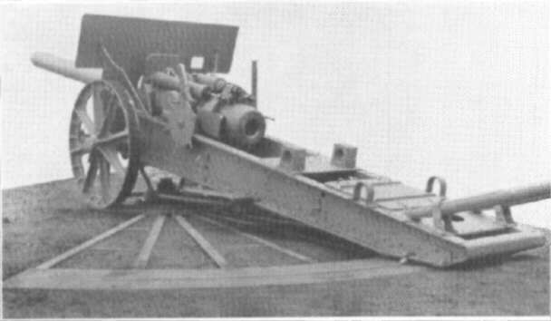

        The drawing here is of the modified 10.5 cm leFH-98/09 seen below. The original leFH-98 did not have a recoil system.
        Correct.
        The second howitzer illustrated is actually the Krupp commercial 10.5cm M-1912/16 field howitzer...

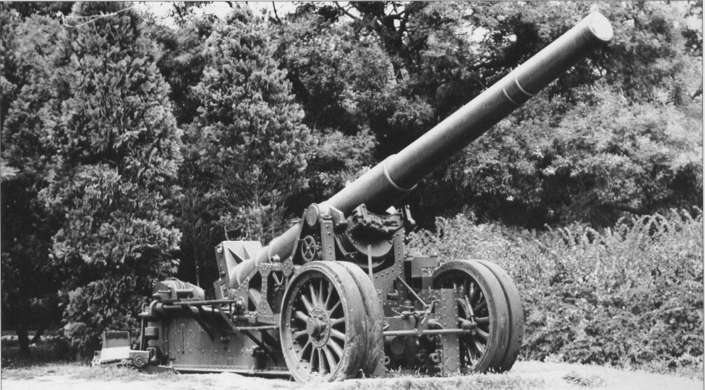

                Another ex French coast gun?
                Gun model : Schneider 220mm M 1917
                French designation : Canon de 220mm Long Mle. 1917
                Calibre : 220mm L/35
                Weight : 9280 kg
                Weight in action : 23000 kg
                Weight in marching order : 25880 / 30120 kg
                Barrel lenght : 7.700 m
                Shell weight : 104.75 kg. (bursting charge: 14-20 kg)
                Muzzle velocity : 766 m/s
                Max. range : 22800 m
                Elevation : + 37° / 0°
                Traversing angle : 20° (with platform : 50°)
                Remarks : Heavy gun.
                In Varna Naval Museum there are two of these guns. According with Hans MEHL, Feld-und Festungsartillerie. Heeresgeschütze aus 500 Jahren. Band 1: 1450 - 1920, page 141, Bulgarian used one of these guns to defend Varna Bay, but is very unlikely since it was introduced in French Army only in June 1918. At the beginning of WW2 French Army had 68 of these guns and many of them were captured by German Army in 1940. At least eight 220mm Schneider guns M 1917 were sent to Bulgarian Army that used them to defend the coast of Thrace (4 guns at Kavala and 4 at Dedeagatch). So I think that the gun in Varna came only during WW2.

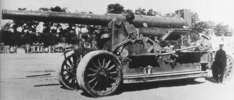

                      15cm Krupp Heavy Gun
                      Gun model : Krupp 150mm heavy gun on wheeled carriage
                      German designation : schwere 15cm Kanone i.R.
                      Calibre : 149.1mm L/40
                      Weight : 11820 kg
                      Weight of the platform : 7450 kg
                      Barrel lenght : 7.670 m
                      Shell weight : 44.2 kg
                      Muzzle velocity : 750 m/s
                      Max. range : 18700 m
                      Elevation : =
                      Traversing angle : 60°
                      Remarks : Long range heavy gun built in two version : the more common L/40 and the longer L/45. In Varna Naval Museum there are two of these guns, one L/40 and one L/45. Were these guns used as coast artillery? I don’t know, but I have some doubts. I think that they were used by German Units in Macedonia. In october/november near Monastir 1916 11th German Army had two batteries armed with 150mm long gun: schw.15cm KnBt. 16 and 20. They remained in Macedonia till the end of the war and schw.15cm KnBt. 16 with three guns fought also at Doiran in 1917. I think that they were armed with the 150mm heavy guns L/40 and L/45.
                      For other informations and images of this gun see:
