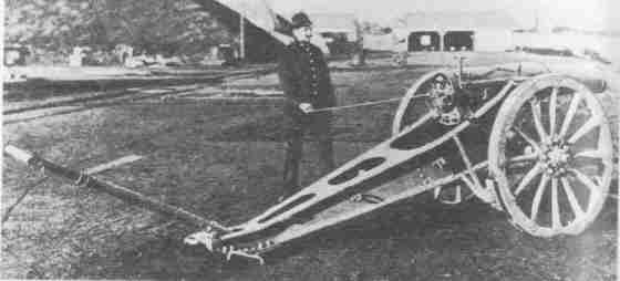

    Btw, there are TWO different French models on pictures - on the left is classic Puteaux Mle.16,
    and the crude-looking one (on the right) is complete mystery for me.
    Yes, I know it.
    The photo of the second gun comes from Eugenio D'ANTONI, Storia della prima guerra mondiale 1914-18, Mario Stavolta Editore, Pordenone 1979, II, p. 498. The text says "French 37mm compress air trench gun". That's all.
    As fot the data of Hotchkiss and Skoda Infantry Guns, I can only say:WOW, great! :tup:
    Since you are so well informed, maybe you can add something or correct anything in my previous post.
    Every addition is greatly welcomed!

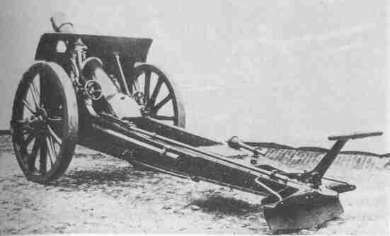

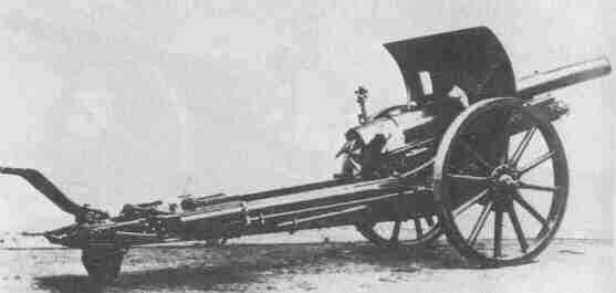

                      • MCP
                        • Jan 2005
                        • 372
                        #116
                        Turkish Heavy howitzers
                        I have to say the same for the fourteen 15cm heavy howitzers that Bulgarian Army had in 1915. Since the howitzers that Turkish Army bought in 1905 and received 1908 are not Krupp M. 1902 I add here the data of the Turkish modell.
                        Gun model : Krupp 150mm QF Turkish
                        German designation : 15 cm Haubitze L/14
                        Calibre : 149,1mm L/14
                        Weight in action : 2290 kg
                        Tube Lenght: 2100 m
                        Shell Weight : 41 kg
                        Muzzle Velocità : 300 m/s
                        Max. Range : 6815 m
                        Elevation : + 43° / - 5°
                        Traversing angle : 5°
                        Remarks : Quick firing heavy howitzer with hydraulic recoil system, running-out springs, single-motion wedge breech mechanism, shielded.

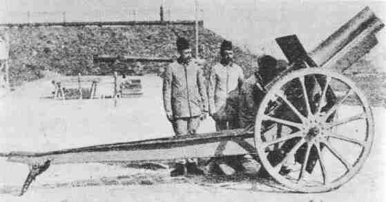

                        • MCP
                          • Jan 2005
                          • 372
                          #117
                          Bulgarian Howitzers - new pictures
                          Since I cannot add further picture in my post n° 12, I put them here.

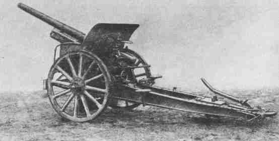

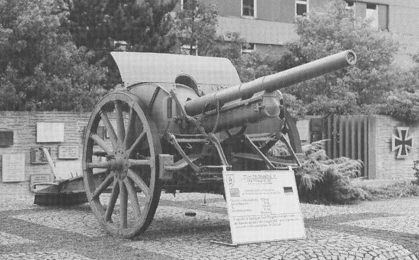

                            #118
                            German Field guns - additions
                            Previously I said that I had no evidence that Germany sent the new 7.7cm FK 16. Now I have found that no Krupp Field gun M. 1896/1916 were sent to Bulgarian Army, but Bulgaria received a little number of Rheinmetall M. 1916.
                            Gun model : Rheinmetall 77mm QF M. 1916
                            German designation : 7.7cm FK 16
                            Calibre : 77mm L/35
                            Weight : 1325 kg
                            Tube Lenght : 2.695 m
                            Shell Weight : 7.2 kg (5.89 kg with Granate/C-Geschoß from 1917)
                            Muzzle Velocity : 545 m/s (602 m/s with Granate/C-Geschoß from 1917)
                            Max. Range : 9100 m (10700 m with Granate/C-Geschoß from 1917)
                            Elevation : + 40° / - 10°
                            Traversing angle : 4°
                            Remarks : Quick firing field gun. This gun had a longer tube with a different twist of rifling than the FK 96 n/A. The shell and shrapnel remained the same, but the propellent was in two different charges, the greater one containing more powder than before. The tube was mounted on the carriage of the leichte Feldhaubitze 16, introduced at the same time.
