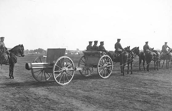

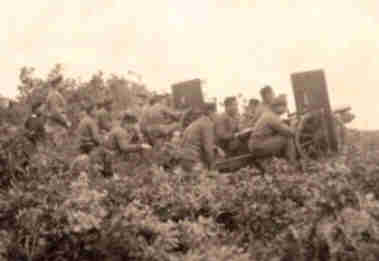

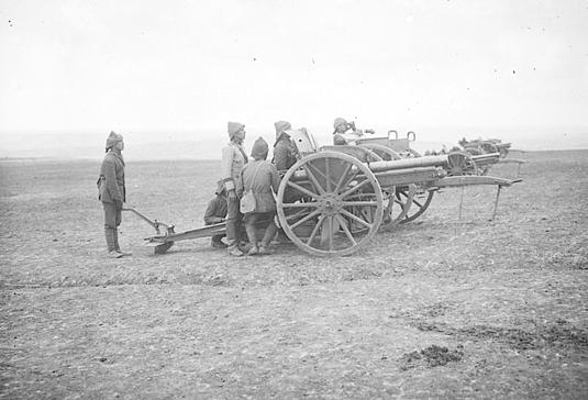

      Pictures number 4, 5 and 8 probably do not show a Bulgarian soldiers. The hats and the shoes are certainly not Bulgarian.

        #4
        Yes, pictures of Krupp 75mm are showing Turkish guns. These guns were captured by Turkish Army in Balkan War.

        • Гост
          #5
          I see. The Turkish uniform is from WWI or later (?)
          Is there any information when and how these guns have been captured? From the Bulgarians?

            #6
            Sorry, my previous post is not correct.
            Krupp 75mm Field Gun were capture FROM the Turks BY Bulgarian Army.

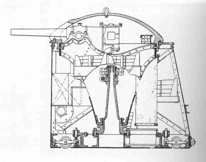

                Remarks : Quick firing gun in a mobile armour housing of Gruson design; in 1913 four these guns were captured by Serbian near Belogradzhik. Everywhere I found that this guns was M. 1900 or M. 00, but since it seems that Bulgarian Army bought it in 1893, I think there was a mistake in western sources.

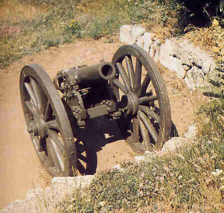

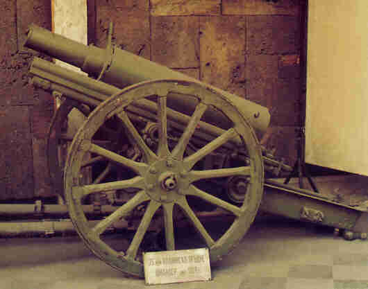

                      Mountain Artillery
                      Gun model : Schneider-Canet 75mm QF M. 1907
                      Calibre : 75mm L/16
                      Weight : 120 kg
                      Weight without limber : 506 kg
                      Weight of the shield : 76 kg
                      Tube Lenght : 1.200 m
                      Shell Weight : 5.1 kg (bursting charge: 0.1 kg)
                      Shrapnel Weight : 5.1 kg (200 balls x ? gr - bursting charge: 0.1 kg)
                      Shrapnel Fuze : time and percussion
                      Muzzle Velocity : 330 m/sec (shrapnel)
                      Max. Range : 5050/5200 m
                      Elevation : + 30° / - 10°
                      Traversing angle : 4° 30’
                      Thickness of shield: 4 mm
                      Track : 0.93 m
                      Ammunition : 128 (16 boxes, with 8 rounds each, each ammunition pack animal carrying 2 boxes - each ammunition box with 8 rounds weights 52.3 kg)
                      Transport : 5 load: 1 - gun; 1 - carriage and axle; 1 - shield and fittings; 1 - cradle, 1 - trail and wheels
                      Remarks : Quick firing mountain gun, with hydro-pneumatic recoil system, eccentric screw breech mechanism, not fitted for an indipendent line of sight.
                      Gun model : Krupp 75mm QF M. 1904
                      Calibre : 75mm L /14
                      Weight : 104 kg
                      Weight without limber : 384 kg
                      Weight of the shield : 26 kg [it seems not correct]
                      Tube Lenght : 1.050 m
                      Shell Weight : 5.1 kg (bursting charge: 0.16 kg)
                      Shrapnel Weight : 5.1 kg (200 balls x ? gr - bursting charge: 0.16 kg)
                      Max. Range : 5000/5000 m
                      Elevation : + 25° / - 10°
                      Traversing angle : 2° each side
                      Track : 0.74 m
                      Transport : 4 loads: 1 - gun; 2 - carriage, recoil tubes, shield; 1 - cradle, wheels, shaft
                      Remarks : Quick firing mountain gun with hydro-spring recoil system, single-motion wedge breech mechanism.

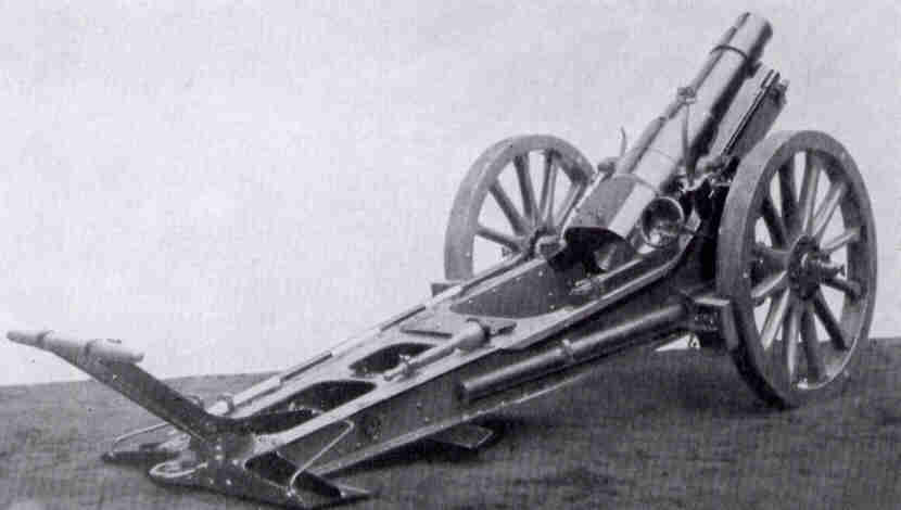

                        Howitzers
                        Gun model : Krupp 150mm QF M. 1902
                        German designation : 15cm sFH 02
                        Calibre : 149,7mm L/12
                        Weight : 1075 kg
                        Weight of the carriage: 1115 kg
                        Weight in action : 2035 kg
                        Tube Lenght: 1.770 m
                        Shell Weight : 42 kg
                        Muzzle Velocità : 325 m/s

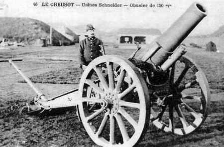

                        Gun model : Schneider-Canet 150mm M. 1897/05
                        Calibre : 150mm L/12
                        Weight : 722 kg
                        Weight with breech mechanism : 777 kg
                        Weight in action : 1965 kg
                        Weight of the limber : 641 kg
                        Tube Lenght : 1.810 m
                        Shell Weight : 40 kg (bursting charge: 2.8 kg)
                        Shrapnel Weight : 40 kg
                        Dynamite Shell Weight : 40 kg
                        Muzzle Velocity : 360 m/sec
                        Max. Range : 7800 m
                        Elevation : + 45° / - 5°
                        Track : 1.30 m
                        Wheels diameter : 1.27 m
                        Ammunition : gun limber - 5, wagon - 25
                        12 ammunition wagons for every battery
                        Remarks : Heavy howitzer à tir accéléré, i.e. old guns modernized in 1905 (see Henry BARBY, Brégalnitsa, Paris, Bernard Grasset 1914, page 309): some sources speak of them as “not quick firing” and others as “quick firing” howitzer; with hydro-pneumatic recoil system, eccentric screw breech mechanism, equipped with panorama sight, but not fitted for an indipendent line of sight. I am not sure wether this howitzer had a shield. The original model had no shield, but since the Austro-Hungarian Feldbuch Die Bulgarische Armee September 1915 says that it had "Schutzschilde", it may have been added when the howitzer was upgraded in 1905.
                        For additional pictures of these howitzers, see Bulgarian Howitzers - new pictures.
