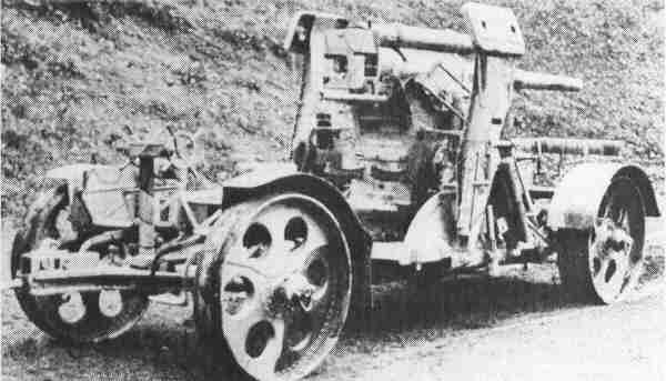

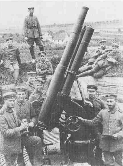

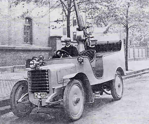

        Anti-aircraft Artillery
        Germany was the first country that studied the opportunity to have guns purposely designed for combatting balloon, dirigibles and planes. In 1906 at the Berlin automobile exhibition Rheinmetall showed a 5cm L/30 pivot gun mounted on a lightly armoured motor car, while Krupp choose a 6.5cm L/35 gun. The tactic suggested was to deploy these vehicles in likely places and, on the appearence of an aircraft, to drive them rapidly to some point of interception and there open fire.
        At that time War Ministry believed that there were non need for special guns and in 1907 German Army tested as anti-aircraft guns the guns then adopted by field and foot artillery: 7.7cm field gun, 10.5cm light field howitzer and 10cm heavy gun. In spite of the lack of interest shown by the Army, studies went on. Between 1908 and 1910 a lot of new guns appeared. Krupp produced a 7.5cm L/35 gun on wheels and a 7.1cm L/30 gun on a motor car, while Rheinmetall a 6.5cm L/35 pivot gun. This time War Ministry was more interested to and laid down the rules for the Ballonabwehrkanone (Bak = anti-balloon gun). These demanded the calibre and the ammunition of the 7.7cm L/27 field gun and devices for a rapid change in azimuth and elevation. The gun had to be transported by a field carriage or mounted on a motor car with a pivot. Between 1911 to 1914 both Krupp and Rheinmetall produced some different pattern of Bak.
        It was only from 1910 to 1914 that the military leaders of the other major European countries began to examine the prospect of anti-aircraft weapons. In Great Britain Vickers produced a 3-pounder quick firing gun mounted on a Daimler car chassis, while in France for the 75mm Mle 1897 field gun it was developed a high-angle mounting for on the back of a De Dion Bouton car chassis. But at the beginning of the World War 1 only Germany could field a little number of anti-air guns.
        In August 1914 Germany had available six motor Bak with a 77mm L/27, two wheeled 77mm L/27 with pivots, and ten mixed older models of experimental 77mm dating back to 1910-1914. The horsedrawn Bak were emplaced near bridges over the river Rhein at Dusseldorf and Mannheim, at the Zeppelin wharf at Friedrichshafen, and at the dirigible hangar at Metz. The six motorized Bak went to the 4th, 5th, 6th, 7th (two) and 8th Army. They were emplaced to protect areas and objects important for mobilization. The development of anti-aircraft artillery in German Army was very quick.
        In October 1914 there were 9 motorized and 27 horse-drawn Bak.
        In January 1915, thanks to a great use of captured guns, there were 97 Bak, mostly armed with Belgian, French and Russian field guns transformed into anti-aircraft gun.
        When World War 1 ended German Army had 2576 Flak (Fliegerabwehrkanone = anti-aircraft gun, from 31th May 1916 the new name of Bak).
        There were :
        - 116 heavy motorised batteries
        - 39 light motorised batteries
        - 168 horse-drawn batteries,
        - 166 fixed batteries,
        - 3 railway batteries,
        - 183 motorised sections;
        - 49 horse-drawn sections;
        - 173 fixed sections;
        - 80 individual motorised veihicles.
        In September 1918 German Army had in Macedonia :
        Bespannte FlakBt. 523, 549, 550, 556 (horse-drawn Flak Batteries);
        Bespannte Flakzug 97 (Saxon), 165 (horse-drawn Flak Sections);
        Bespannte bayer.Flakzug 119, 148 (horse-drawn Bavarian Flak Sections);
        9cm FlakBt. 338 (9cm improvised Flak Battery - Saxon);
        KraftwagenFlak 38, 85 (Flak on motor vehicles).
        These units were to the Flak Command of Army Group Scholtz (Kommandeur del Flak der Heeresgruppe Scholtz). There were also two Flak officiers, one for German 11th Army and one for Bulgarian 1st and 2nd army).

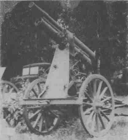

          ex Turkish Bak guns
          Gun model : Krupp 75mm QF M. 1912
          Calibre : 75mm L/30
          Weight :
          Tube Lenght : 2.250 m
          Shell Weight : 6.35 kg
          Muzzle Velocity :
          Max. Range : 6500 m
          Elevation : + 90°
          Elevation : 360°
          Remarks : Quick firing Bak gun
          Calibre : 75mm L/28
          Weight :
          Tube Lenght : 2.100 m
          Muzzle Velocity :
          Max. Range : 6500 m
          Elevation : + 90°
          Azimuth : 360°
          General remarks
          Taking advantage of the studies carried out by German factories at the beginning of XX century and of their production of a number of sperimental Bak guns, in 1912 Ottoman Army bought in Germany four 75mm Krupp Bak guns. They had the same performances, but they were not all the same pattern of guns. Two of them had a caliber of 75mm L/28, while the others had a longer tube (L/30). Two of them - one of every pattern - were sent to Odrin in order to defend the fortress by ennemy’s balloon, dirigibles and planes. In 1913 Bulgarian Army captured these two guns. These are the first real anti-aircraft guns in Bulgarian Army. During Balkan war Bulgarian Army had used regular field artillery guns to fire on air targets. In October 1915 they formed the 1st Anti-aircraft Section.

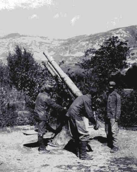

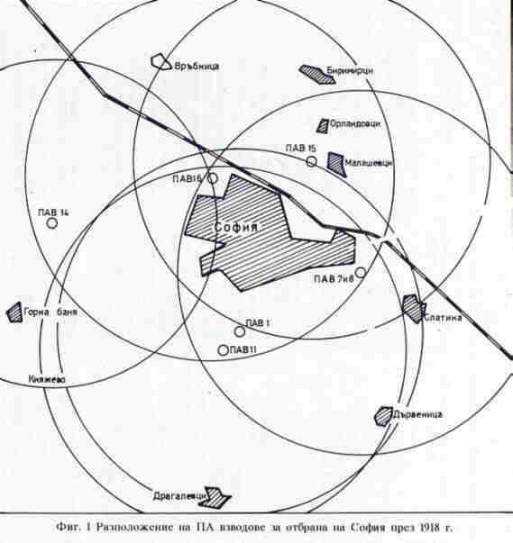

                Bulgarian Anti-aircraft Artillery
                1915
                Bulgarian Air Defence (ПАО) was born on 9 October 1915 when, according with the ordnance n° 31, it was formed the first AA Battery (ПАБ). It was composed by three AAPlatoon (ПАВ): the first one had the two 75mm Bak seized as trophies in Odrin in 1913, the other two had each two 87mm Krupp slow firing field guns on improvised mounting. This unit was built in order to protect Sofia and on 27 October 1915 it took up it positions in the capital: 1st ПАВ was placed in the aerea of Lozenech, 2nd ПАВ an in Slatinski Redubt and 3rd ПАВ at Konyovitza. Besides these six guns, ПАО had seven machine guns (five Madsen and two Hotchkiss). They were used to protect some important military target in Sofia: Vrana Palace, airport, military arsenal, railway station, "Balkan" Company, gunpowder depot and firearms depot. They have telephone conection with each other an there was one to three infantry platoons ready 24 hours to fire on the enemy planes with regular infantry weapons.
                On the same day the artillery commander of Sofia fortress, Col. Atanas Rakoski, was appointed Head of Bulgarian Air Defence. His first task was to provide the capital and the strategic bridges at Kuleliburgas and Fere-Dedeagach with air defence. 3rd ПАВ was sent to Kuleliburgas, while another platoon armed with two two 87mm Krupp slow firing field guns was assigned to 10th Belomorska Division and placed at Fere-Dedeagach.
                On 30 October 1915 it was organized the anti-air defence of Bulgarian strongpoint along the bank of river Danube:
                - Ruse - six 87mm Krupp with an infantry detachment
                - Svishtov - six 87mm Krupp with an infantry detachment
                - Somovit - two 87mm Krupp with an infantry detachment
                - Lom - eight x 87mm Krupp with a cavalry squadroon.
                The artillery was entirely formed by slow firing field gun on improvised mounting.
                On 15 December 1915 ПАО was composed by:
                1st ПАБ - Captain Bogdan Bonev (Sofia)
                -- 1st ПАВ - Capt. Bogdan Bonev (Lozenech) - two 75mm Krupp Bak (trophies)
                -- 2nd ПАВ - Off. cand. Stefan Balabanov (Kjustendil) - two 87mm Krupp slow firing guns
                -- 3rd ПАВ - Off. cand. Todor Shishkov (Kuleliburgas) - two 87mm Krupp slow firing guns
                2nd ПАБ (formed on 5 November 1915) - Lieutenant Stefan Oreshkov (Sofia) -
                -- 1st ПАВ - Serg. Georgi Balabanov (Konyovitza) - two 87mm Krupp slow firing guns
                -- 2nd ПАВ - Serg. Georgi Nestorov (Slatinski Redubt) - two 87mm Krupp slow firing guns
                -- 3rd ПАВ - Serg. Petar Petrov (Telegraph Battalion) - two 87mm Krupp slow firing guns
                3rd ПАБ (formed on 1 November 1915) - Captain Ivan Marinov (Kuleliburgas)
                -- 1st ПАВ - (bridge on Arda river) - two 87mm Krupp slow firing guns
                -- 2nd ПАВ - (Kuleliburgas railway station) - two 87mm Krupp slow firing guns
                -- 3rd ПАВ - (Fere) - two 87mm Krupp slow firing guns
                There were also seven MG half companies:
                -- five were placed in Sofia : at "Balkan" Company, railway station, Vrana Palace, and airport;
                -- two at Kulelyburgas : on the bridge on Martza river and at the railway station.
                1916
                During 1916 new batteries and platoons were formed in order to protect every military target in Bulgaria.
                On March 1916 one ПАБ was formed in Kjustendil with guns coming from Kuleliburgas.
                On May 1916 a third ПАБ was formed in order to protect Sofia.
                On August 1916 three new batteries were formed in Sofia:
                - one, armed with two 75mm slow firing guns, from Military School;
                - one, armed with four 87mm slow firing guns, from a replacement battery of 4th Field Artillery Regiment;
                - one, armed with four 87mm slow firing guns, from Sofia Fortress Regiment.
                Four more MG emplacements were formed. They were placed to protect Mint, Military club, War Ministery and railway station.
                On July and August 1916 it was also organized the anti-air defence of Northern Bulgaria :
                - Kaspichan - one ПАВ
                - Razgrad - one ПАВ
                - Drjanovo - two ПАВ
                - Gorna Orjahovitza - two ПАВ
                In order to defend the seashore of Thrace ПАО formed eight ПАВ (21st to 28th).
                1917
                On 1 July 1917 ПАО was composed by:
                - Staff with two officiers and four men
                - 9 ПАБ armed with 57 guns
                - 3 machine guns half companies
                together with 19 officiers, 6 (?) NCOs and 614 privates (the number of NCOs seems to me too low and I think it is wrong).
                There were 35 ПАВ and 27 MG emplacements. During July 1917 every ПАВ received one Schwarzlosе MG for its defence (in sum 20 MGs).
                On 25 July 1917 8th and 9th ПАБ were armed with special anti-air guns sent by German Army (76.2mm Russian guns seized as trophies). 8th ПАБ was assigned to Bulgarian 2nd Army, 9th ПАБ to Bulgarian 1st Army (34th ПАВ to 5th Dunavska Division) and German 11th Army (32th ПАВ to 2nd Trakiska and 33th ПАВ to 3rd Balkanska Division).
                In the second half of 1917 a 10th ПАБ was formed.
                On 1 December 1917 ПАО had twelve ПАБ.
                1918
                In Juanary 1918 11th ПАБ was rearmed with 76.2mm Russian guns.
                In the first quarter of 1918 :
                - 12th ПАБ was armed with 75mm Schneider field guns.
                - a new 13th ПАБ was formed in Sofia with 1st and 11th ПАВ.
                - 14th ПАВ was rearmed with 75mm Krupp field guns and assigned to Bojurishte airfield.
                - in its place at Konyovitza was formed a 49th ПАВ armed with one 75mm field gun.
                - 3rd ПАВ armed with 87mm slow firing Krupp field guns was formed at Kjustendil.
                On 1 August 1918 ПАО was composed by:
                Staff with three officiers and five men
                - 13 ПАБ
                - 5 machine guns half companies
                together with 25 officiers (among them 7 officier candidates), 243 NCOs and 679 privates.
                On 11 October 1918 ПАО formed its last unit : 50th ПАВ in Ohrid. In order to protect all firearms depots twenty-two MG emplacements were formed.
                From МИНИСТЕРСТВО НА ОТБРАНАТА- ИНСТИТУТ ЗА ВОННА ИСТОРИЯ, История на зенитната артилерия и зенитно- ракетните войскн в Българската Армия, Sofia 1995, pages 13-37

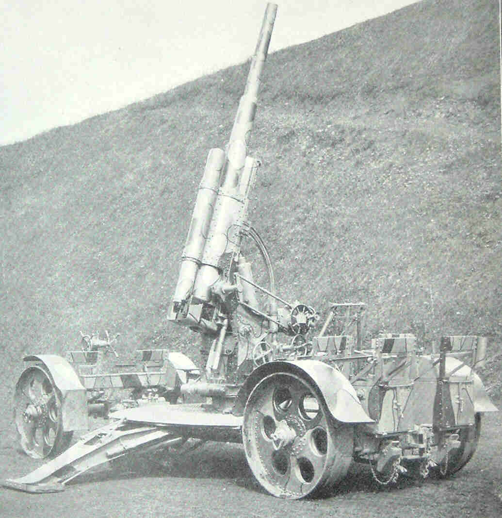

                          ex German Flak
                          Gun model : Krupp 88mm QF M. 1916
                          German designation : 8.8cm Kw-Flak
                          Calibre : 88mm L/45
                          Weight: 6125 kg
                          Tube Lenght : 4.010 m
                          Shell Weight : 9.6 kg
                          Muzzle Velocity : 718 m/s
                          Max. Range - horizontal: 18300 m
                          Max. Range - vertical: 6700 m
                          Elevation : + 70°
                          Azimuth : 360°
                          Remarks : Anti-aircraft gun mounted on pedestals on motor cars (Kw = Kraftwagen). This gun was mounted on a 4 wheel trailers towed on specially fitted army lorries. When in action arms with jacks were swung out to form a secure firing platform. In 1916 this gun was extremely mobile and could swiftly be ready to fire. A similar gun was built by Rheinmetall. In 1916 German Army used some of these guns to protect ports of Black Sea (Varna and Burgas). At least three of them were used by Bulgarian Army during, or more likely after, World War 1. They were still in used by Bulgarian Air Defence in 1920s-1930s

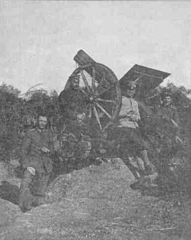

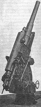

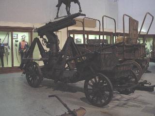

                            Pictures:
                            I have added four different picture of the so called "special Russian anti-aircraft gun" (специално 7,62-см руско противоаеропланно оръдие):
                            1. a 76.2mm gun used by Bulgarian Army
                            2. a 76.2mm gun M. 1900 or 1902 mounted on pedestals used by the German Army
                            3. a 76.2mm gun M. 1900 or 1902 mounted on trucks used by the German Army
                            4. a 76.2mm anti-aircraft gun M. 1914 used by the Austro-Hungarian Army

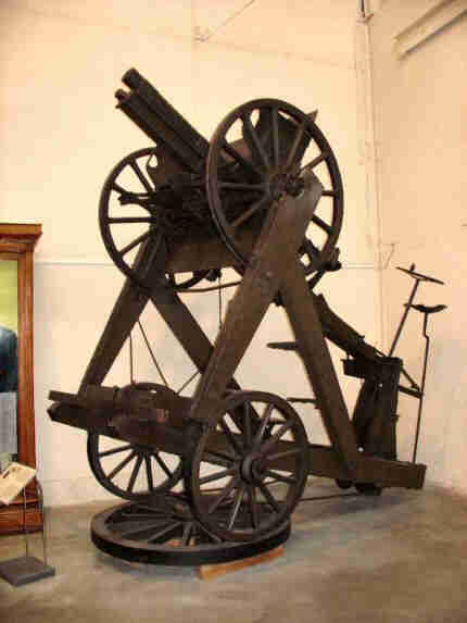

                              Pictures:
                              Unfortunately I could not find any picture of an old 87mm gun adapted for anti-aircraft work by German or Bulgarian Army. Pictures:
                              The first picture show a Schneider gun mounted on the special platform developed by col. Rakovski.
                              Thanks to Nick for the help.
