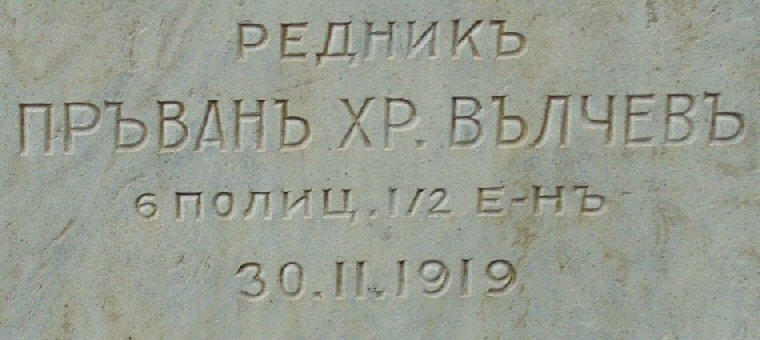

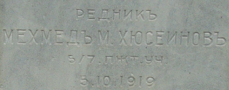

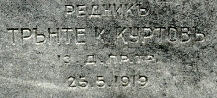

    "Пех.Полкъ" is easy enough to understand, but I would be grateful if someone could tell me what is meant by the following abbreviations:
    13.Д.ПР.ТР.
    5/7.ПЖТ.УЧ.
    6 ПОЛИЦ. 1/2 Е-НЪ (=ескадронъ? Military police half-squadron?)

    5/7.ПЖТ.УЧ. (or more likely 5/7 ПГР.уч.) - 5/7th border guard section?
    6 ПОЛИЦ. 1/2 Е-НЪ - 6th military police half-squadron
    13.Д.ПР.ТР. - does not make sense to me

        5/7.ПЖТ.УЧ. - 5/7 Пжтен участъкъ (Old Bulgarian) - 5/7 Пътен Участък (Modern Bulgarian) - 5/7 Road Section (road maintenance section)
        6 ПОЛИЦ. 1/2 Е-НЪ - 6 полицейски полуескaдрон- 6th military police half-squadron

          13.Д.ПР.ТР. - I think I found it:
          It is "3-ти дивизионен продоволствен транспорт" or in English "3th divisional supply column" оr "3th divisional supply transport" to be exact.
          Although on the grave the "I" before the 3 is visible and the letter П is actually Г, there are several facts, that lead me to believe they made mistake on the abbreviations. In WW1 Bulgaria did not have 13th divison nor I can find any unit whose inscription is ГР. ТР.

            Not much to add to the Dibo's explanations. It is however possible that by the "13th divisional supply column" is meant the divisional supply column of the Combined infantry division (Sbornata pehotna divizia). The division itself was not numbered 13th (probably out of cheer superstition), yet the artillery brigade of this division was given number 13 (13 artilerijska brigada)-according to the OOB of the Bulgarian army on 15 September 1918, annexed to the book "Zashto ne pobedihme" (Reasons why we didn't win) by col. Stefan Noykov.
