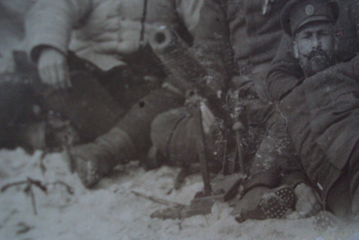

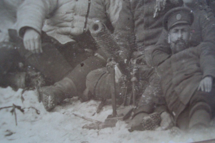

                    An old picture...a decade later
ID:	554013Click image for larger version
ID:	554014Click image for larger version
ID:	554015Click image for larger version
ID:	554016Click image for larger version
